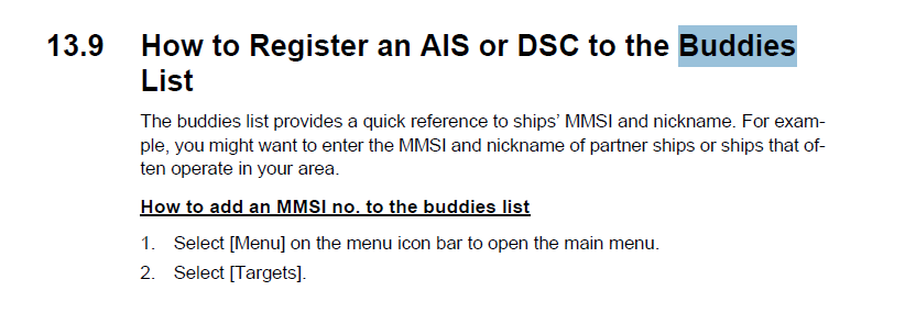

Titanic II Moderator Staff member Nov 28, 2023 #4 On the TZT9/14/BB you can create an AIS/DSC Buddies List. You can refer to partner boats by adding a nickname so you can pick them out easier by seeing the nickname you have assigned to your buddies. Last edited: Nov 28, 2023
