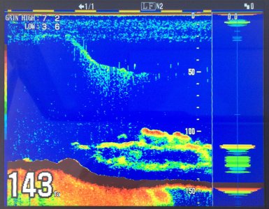

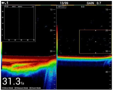

Thank you for your inquiry. You have made an excellent observation. The bottom tail (thickness) is tied to a bunch of factors but we some of the more common concepts include the following: The bottom tail will typically be thicker with a harder bottom composition than with mud or sand. If you take all the other factors out of it this is a pretty consistent. Please see the photo below, you will notice the bottom tail changes this would indicate a harder bottom moving towards a softer bottom.

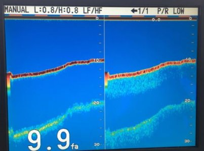

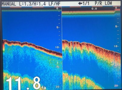

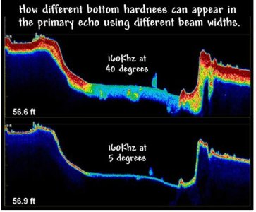

Lower frequencies tend to yield a thicker the bottom tail than higher frequencies. You already observed this, we also know that typically the wider the beam angle the thicker the bottom tail. Which works together with frequency, typically the lower the frequency the wider the beam angle hence a thicker bottom. Please see photo below. Comparing low and high frequency and narrow vs. wide beam angle with a fixed frequency.

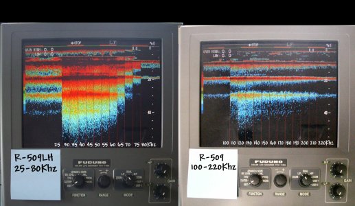

Lastly we have done a sweep test on that transducer please see the photo below. You will see in the photo what frequency responded with the strongest return echos.

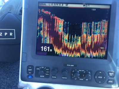

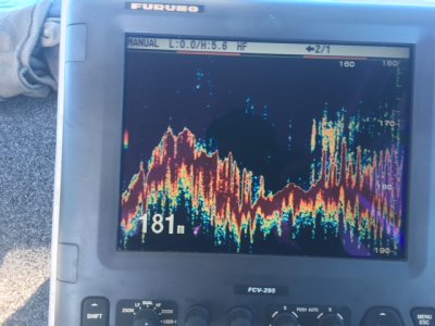

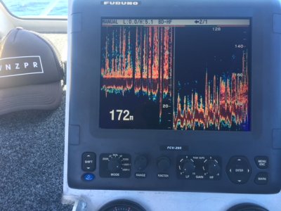

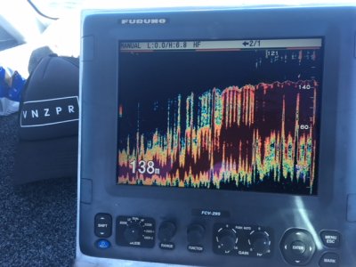

Hi guys, finally got back out fishing and took some pics and i figured out what was wrong !, i pulled the cover off the back and had a look and the high frequency plug wasnt plugged in properly so now i have fixed it its working alot better a lot more power what i was expecting.
What do you think now ?

Another pic

Stevehowlett,
Thanks for the screen shots.
What were the sea conditions, looks like you were rolling around quite a bit.
The sea conditions weren’t to bad was 2-2.5m swell and a steady breeze a few of those shots were on the drift and not moving much might explain why it looks like we were rolling.
