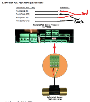

B buckshot Furuno Super Fan Dec 2, 2023 #1 53321 NavPilot 711C Control Unit 48043 FAP7002 Processor Unit FURUNO PUMPHRP17-24 can I use the already installed Garmin flow switch? Shadow Drive GHP pn/ 010-11054-00

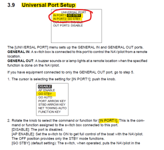

Titanic II Moderator Staff member Dec 4, 2023 #2 I cannot guarantee that it will work, but since you have it installed we might as well give it a shot. Jumper the Sensor RED wire to TB5 pins 2 and 5. Jumper the Sensor BLACK wire to TB5 pins 6 and 6. Set the UNIVERAL Port IN PORT 1 and Port 2 to "GO STBY".
