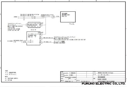

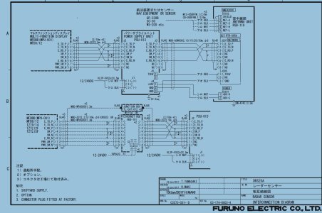

S sdonx Furuno Fan Aug 19, 2023 #1 Will my existing wiring work? I know I don't require the PSU-13. Seems the X is a RJ45 with 24v power which is what I think I have. See schematics below: Attachments 25AX Capture.JPG 106.7 KB · Views: 4 25A wiring Capture.JPG 157.2 KB · Views: 4
S sdonx Furuno Fan Aug 23, 2023 #3 Johnny answered on another post. The X is drawing more amperage so wiring would have to change.
